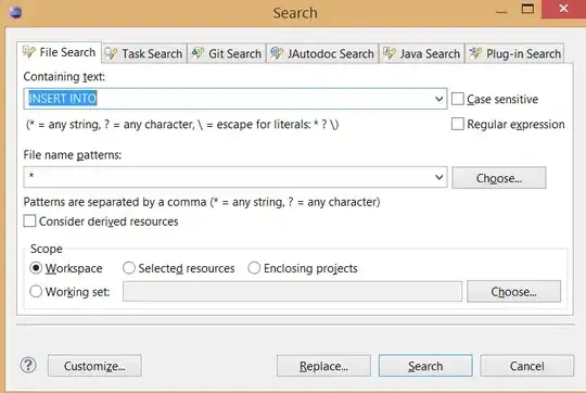

1. Ctrl + H
2. Choose File Search for plain text search in workspace/selected projects
For specific expression searches, choose the relevant tab (such as Java Search which allows you to search for specific identifiers)
For whole project search:
3. Scope (in the form section) > Enclosing project (Radio button selection).

22"CTRL-H -> File Search (TAB) -> Scope (FORM SECTION) -> Enclosing projects (RADIO BUTTON OPTION)" will work for only the current project where you are coding. – JStrahl Sep 06 '13 at 07:17
2@Strahlee that is actually what brought me to this question. ctrl+H is well documented over the internet, but it does a global search on ALL projects in the package explorer, which is very very annoying. By using the Enclosing Projects option, it appears to limit the search per project. The answer here should be updated to reflect this. – JohnMerlino Jun 16 '14 at 05:33
5With Eclipse Kepler, you need to fill the `File name patterns` too, e.g with `*`. Until this information is given, the `Search` button is grayed. Didn't know a search function could be so cryptic before meeting with Eclipse. – mins Sep 15 '14 at 21:16
1I have multiple projects, but only want to search one. How do I do that? – Mawg says reinstate Monica May 23 '17 at 10:00

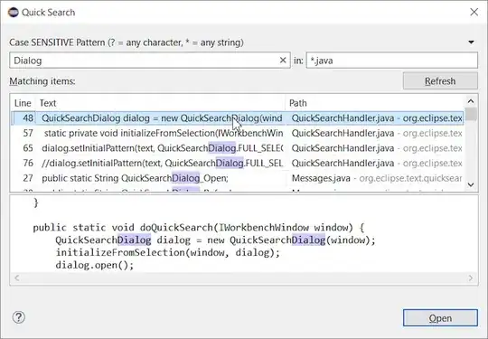

You should check out the new Eclipse 2019-09 4.13 Quick Search feature
The new Quick Search dialog provides a convenient, simple and fast way to run a textual search across your workspace and jump to matches in your code.
The dialog provides a quick overview showing matching lines of text at a glance.
It updates as quickly as you can type and allows for quick navigation using only the keyboard.
A typical workflow starts by pressing the keyboard shortcut Ctrl+Alt+Shift+L
(or Cmd+Alt+Shift+L on Mac).
Typing a few letters updates the search result as you type.
Use Up-Down arrow keys to select a match, then hit Enter to open it in an editor.
1Yes, this is what I`ve been looking for, although, 4 key combination is little too much to remember. Is there any other way to trigger this very window? Thank you in advance. – rchrd Jul 28 '20 at 13:06
1@rchrd Not that I know of. I use three keys to remember the 4 keys combinations: https://stackoverflow.com/a/4105518/6309, https://stackoverflow.com/a/1986236/6309 – VonC Jul 28 '20 at 15:24
CTRL + H is actually the right answer, but the scope in which it was pressed is actually pretty important.
When you have last clicked on file you're working on, you'll get a different search window - Java Search:
Whereas when you select directory on Package Explorer and then press Ctrl + H (or choose Search -> File.. from main menu), you get the desired window - File Search:
