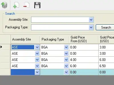

This image shows my Gantt chart and a tooltip out of view...
