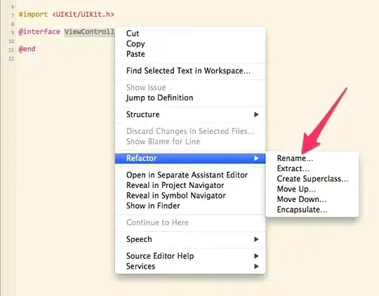

The safest way to rename files is to refactor the class name using Xcode's "Refactor" command. Using that command makes sure that your code is also updated anywhere that references the file or the class (including NIBs).
Right-click on the class name in the interface (.h) file, choose Refactor->Rename, and Xcode will guide you through the process, allowing you to preview changes before you commit to them.

Right click on the class name (after @interface) and choose Refactor->Rename. For example, right click on ViewController in this code:
@interface ViewController : UIViewController

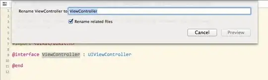

Enter the new name for the class:

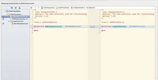

Xcode will let you review the changes before you commit.
