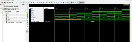

Hi I am a new Xilinx user and been having trouble with how to write stimulus/simulate in a test bench. My output(Kd) isn't giving me any sensible values and gives 'u' for the first few clock cycles before moving and staying at '1' throughout.
Not sure if I have written the correct stimulus but hoping someone would help me out here!

My Testbench ##
LIBRARY ieee;
USE ieee.std_logic_1164.ALL;
-- Uncomment the following library declaration if using
-- arithmetic functions with Signed or Unsigned values
--USE ieee.numeric_std.ALL;
ENTITY codeFig2b_test IS
END codeFig2b_test;
ARCHITECTURE behavior OF codeFig2b_test IS
-- Component Declaration for the Unit Under Test (UUT)
COMPONENT codeFig2b
PORT(
R0 : IN std_logic;
R1 : IN std_logic;
R2 : IN std_logic;
R3 : IN std_logic;
Kd : OUT std_logic;
clock : IN std_logic
END COMPONENT;
--Inputs
signal R0 : std_logic := '0';
signal R1 : std_logic := '0';
signal R2 : std_logic := '0';
signal R3 : std_logic := '0';
signal clock : std_logic := '0';
--Outputs
signal Kd : std_logic;
-- Clock period definitions
constant clock_period : time := 100 ns;
BEGIN
-- Instantiate the Unit Under Test (UUT)
uut: codeFig2b PORT MAP (
R0 => R0,
R1 => R1,
R2 => R2,
R3 => R3,
Kd => Kd,
clock => clock
-- Clock process definitions
clock_process :process
begin
clock <= '0';
wait for clock_period/2;
clock <= '1';
end process;
-- Stimulus process
stim_proc: process
begin
-- hold reset state for 100 ns.
wait for 100 ns;
R0 <= '0';
R1 <= '0';
R2 <= '0';
R3 <= '0';
wait for 100 ns;
R0 <= '0';
R1 <= '0';
R2 <= '0';
R3 <= '1';
wait for 100 ns;
R0 <= '0';
R1 <= '0';
R2 <= '1';
R3 <= '0';
wait for 100 ns;
R0 <= '0';
R1 <= '0';
R2 <= '1';
R3 <= '1';
wait for 100 ns;
R0 <= '0';
R1 <= '1';
R2 <= '0';
R3 <= '0';
wait for 100 ns;
R0 <= '0';
R1 <= '1';
R2 <= '0';
R3 <= '1';
wait for 100 ns;
R0 <= '0';
R1 <= '1';
R2 <= '1';
R3 <= '0';
wait for 100 ns;
R0 <= '0';
R1 <= '1';
R2 <= '1';
R3 <= '1';
wait for 100 ns;
R0 <= '1';
R1 <= '0';
R2 <= '0';
R3 <= '0';
wait for 100 ns;
R0 <= '1';
R1 <= '0';
R2 <= '0';
R3 <= '1';
wait for 100 ns;
R0 <= '1';
R1 <= '0';
R2 <= '1';
R3 <= '0';
wait for 100 ns;
R0 <= '1';
R1 <= '0';
R2 <= '1';
R3 <= '1';
wait for 100 ns;
R0 <= '1';
R1 <= '1';
R2 <= '0';
R3 <= '0';
wait for 100 ns;
R0 <= '1';
R1 <= '1';
R2 <= '0';
R3 <= '1';
wait for 100 ns;
R0 <= '1';
R1 <= '1';
R2 <= '1';
R3 <= '0';
wait for 100 ns;
R0 <= '1';
R1 <= '1';
R2 <= '1';
R3 <= '1';
wait for clock_period*10;
-- insert stimulus here
wait;
end process;
END;
