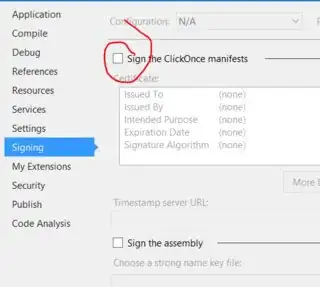

Note: If you are looking for a quick fix and it is okay for your project to not be signed then you can do this. I encounter this problem when I am looking for a sample code, and using this quick fix solves my problem instantly.
  1. Go to the project properties
  2. Select signing options
  3. Uncheck the `Sign the ClickOnce manifests
  4. Save
  5. Re-run it
  6. (Optional) In some cases you need to rebuild it.

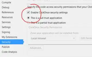

If it doesnt work please try to uncheck the enable ClickOnce security settings which can be located on Security tab.
