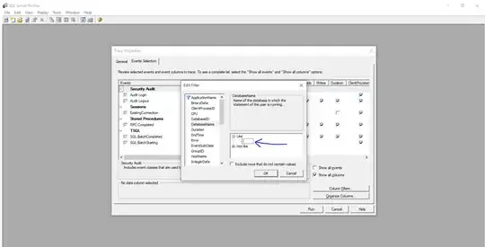

Under Trace properties > Events Selection tab > select show all columns. Now under column filters, you should see the database name. Enter the database name for the Like section and you should see traces only for that database.

Click on the COLUMN HEADER. The filter window will open. – jsgoupil Oct 17 '19 at 18:20

In the Trace Properties go to the Event Selection tab. Then click on the Show All Columns radio button. After that click on the Column Filters button.
Now you can see the Database Name property and click on it. Expand the like box and insert your DB name and click ok and you can run the profiler now.

In the Trace properties, click the Events Selection tab at the top next to General. Then click Column Filters... at the bottom right. You can then select what to filter, such as TextData or DatabaseName.
Expand the Like node and enter your filter with the percentage % signs like %MyDatabaseName% or %TextDataToFilter%. Without the %% signs the filter will not work.
Also, make sure to check the checkbox Exclude rows that do not contain values' If you cannot find the field you are looking to filter such as DatabaseName go to the General tab and change your Template, blank one should contain all the fields.
