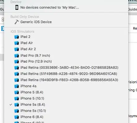

I open my project in Xcode 6.1. When I try to run the project, the button is grayed out. When I try to go to Product > Clean, the option is grayed out. When I look at the list of simulators, all I get is My Mac instead of the usually iOS Device. How do I get my simulators to come back?

Check in Menu Xode->Preferences->Download, if there are all possible simulators. Check your target, is it correct. – Sinri Edogawa Nov 01 '14 at 15:28

Click on the project name (Right to the Run button). Three options will appear.
- Edit scheme
- New scheme
- Manage scheme
You can click on "New scheme" and then click on "OK" in popup window.
You will have simulators list back.
