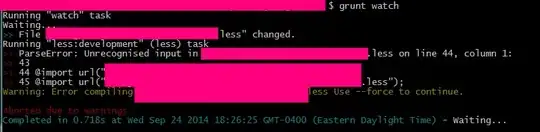

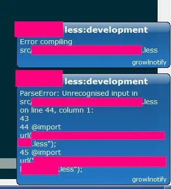

I have setup grunt-notify to trigger whenever less has run using a watch. This works great when the less task fails. Gives me a great pop-up error:
For reference this is the console output:

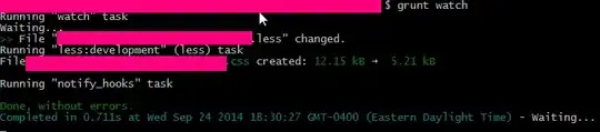

When less succeeds, I am not getting any notification. I would like to get a notification but cannot figure out how to enable this.
This is the console output when less succeeds:
