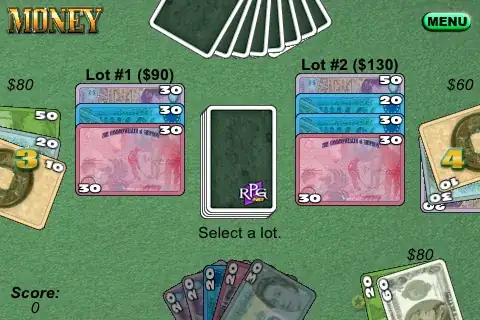

Here's a sample:
Cards that are laid straight are very clean, but whenever they're angled the black lines around the cards get jagged. I've tried this depending on both lines implicit to the artwork and lines drawn through drawRect:, and they both do the same thing. I've tried the edgeAntiAliasingMask and it doesn't do a thing as far as I can tell. I've tried masksToBounds for the sublayers set to NO and YES.
Right now my card is set up as a CALayer that has sub-CALayers for the front and the back, plus for a few other things like a lightening mask and a darkening mask. Here's some snippets of the code:
CArdLayer *theCardLayer = [CArdLayer layer];
theCardLayer.edgeAntialiasingMask = kCALayerLeftEdge | kCALayerRightEdge | kCALayerBottomEdge | kCALayerTopEdge;
theCardLayer.front = [CALayer layer];
theCardLayer.front.edgeAntialiasingMask = kCALayerLeftEdge | kCALayerRightEdge | kCALayerBottomEdge | kCALayerTopEdge;
theCardLayer.front.bounds = theCardLayer.bounds;
theCardLayer.front.masksToBounds = YES;
theCardLayer.front.contents = (id)[cardDrawing CGImage];
[theCardLayer addSublayer:theCardLayer.front];
Etc ...
Any ideas on how to make the cards actually anti-alias?
