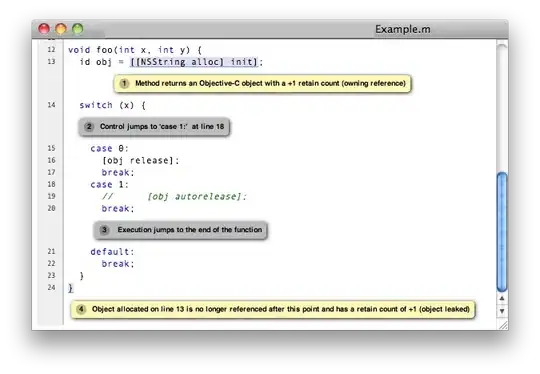

I see a screenshot from the Clang site that shows steps of working viewed in a web browser:
That's probably obtained from Xcode.
The question is: how do I get Clang to output such steps of working from the command line? Or even output results to a browser if it so wishes? This would make the analyzer significantly more useful, and make fixing things much quicker.
