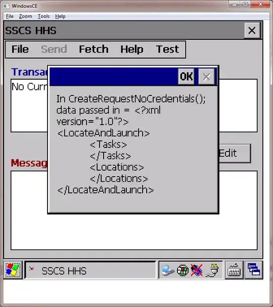

UPDATE 7
I put two debug strings in:
0)
public static HttpWebRequest CreateRequestNoCredentials(string uri, HttpMethods method, string data, string contentType)
//test:
MessageBox.Show(string.Format("In CreateRequestNoCredentials(); data passed in = {0}", data));
1) In SendXMLFile():
//test:
MessageBox.Show(string.Format("After calling CreateRequestNoCredentials(), request contentLen = {0}, headers = {1}, requestUri = {2}",
request.ContentLength, request.Headers, request.RequestUri));
...and I see this:
...but then before the second one gets a chance to show me the gory details, the server receives the null body value, crashes thuswith, and then the client whin[g]es with the same old "This operation cannot be performed after the request has been submitted" complaint.

...stringifiedXML is exactly the same ("")
...but there is an exception:
System.Xml.XmlException was unhandled by user code HResult=-2146232000 Message='1.0' is an unexpected token. The expected token is '"' or '''. Line 1, position 15. Source=System.Xml LineNumber=1 LinePosition=15 SourceUri="" StackTrace: at System.Xml.XmlTextReaderImpl.Throw(Exception e) at System.Xml.XmlTextReaderImpl.Throw(String res, String[] args) at System.Xml.XmlTextReaderImpl.ThrowUnexpectedToken(String expectedToken1, String expectedToken2) at System.Xml.XmlTextReaderImpl.ParseXmlDeclaration(Boolean isTextDecl) at System.Xml.XmlTextReaderImpl.Read() at System.Xml.Linq.XDocument.Load(XmlReader reader, LoadOptions options) at System.Xml.Linq.XDocument.Parse(String text, LoadOptions options) at System.Xml.Linq.XDocument.Parse(String text) at HandheldServer.Controllers.DeliveryItemsController.d__2.MoveNext() in c:\HandheldServer\HandheldServer \Controllers\DeliveryItemsController.cs:line 63 InnerException:
With this as Request Body:
"<?xml version="1.0"?><LocateAndLaunch><Tasks></Tasks><Locations></Locations></LocateAndLaunch>"
...stringifiedXML is "
Penultimately, with this as Request Body:
"<?xml version=\"1.0\"?><LocateAndLaunch><Tasks></Tasks><Locations></Locations></LocateAndLaunch>"
...stringifiedXML is exactly the same thing ("")
...but I get this exception:
System.InvalidOperationException was unhandled by user code HResult=-2146233079 Message=Sequence contains no elements Source=System.Core StackTrace: at System.Linq.Enumerable.First[TSource](IEnumerable`1 source) at HandheldServer.Controllers.DeliveryItemsController.d__2.MoveNext() in c:\HandheldServer\HandheldServer\Controllers\DeliveryItemsController.cs:line 109 InnerException:
And finally, if I pass this, with (albeit bogus) vals within the angulars:
"<?xml version=\"1.0\"?><LocateAndLaunch><Tasks>Some Task</Tasks><Locations>Some Location</Locations></LocateAndLaunch>"
...I STILL get "sequence contains no elements"
This method is more picky than Rachel Canning! What does it want - egg in its beer?!?
UPDATE 13
With this code:
public async void PostArgsAndXMLFileAsStr([FromBody] string stringifiedXML, string serialNum, string siteNum)
XDocument doc = XDocument.Parse(await Request.Content.ReadAsStringAsync());
...or this:
. . .XDocument doc = XDocument.Load(await Request.Content.ReadAsStreamAsync());
...and this as the incoming stringifiedXML:
"Some TaskSome Location"
...I get the exception: "System.Xml.XmlException was unhandled by user code HResult=-2146232000 Message=Root element is missing."
With this code (same stringifiedXML):
XDocument doc = XDocument.Parse(stringifiedXML);
... I get, "System.InvalidOperationException was unhandled by user code HResult=-2146233079 Message=Sequence contains no elements Source=System.Core StackTrace: at System.Linq.Enumerable.First[TSource](IEnumerable`1 source) at HandheldServer.Controllers.DeliveryItemsController.d__2.MoveNext() in c:\HandheldServer\HandheldServer \Controllers\DeliveryItemsController.cs:line 109 InnerException: "
IOW, depending on how I parse the incoming string, I get either "Root element is missing" or "Sequence contains no elements"
What the Deuce McAlistair MacLean Virginia Weeper?!? Isn't "<LocateAndLaunch>" a root element? Aren't "Some Task" and "Some Location" elements?
