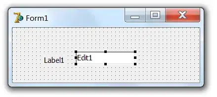

Drop a
Labeland anEditon a form:
Add an
OnEnterevent for theTEdit:procedure TForm1.Edit1Enter(Sender: TObject); begin Label1.Font.Style := Label1.Font.Style + [fsBold]; end;and set the form:
WindowStateto wsMaximizedAutoScrollto False
And bazinga, fails.
