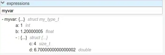

In addition to using the command line option, you can also use graphical debuggers. I suggest gdbgui, but there are quite a few out there.
Disclaimer: I am the developer of gdbgui
