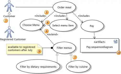

Extend is used when a use case adds steps to another first-class use case.
For example, imagine "Withdraw Cash" is a use case of an Automated Teller Machine (ATM). "Assess Fee" would extend Withdraw Cash and describe the conditional "extension point" that is instantiated when the ATM user doesn't bank at the ATM's owning institution. Notice that the basic "Withdraw Cash" use case stands on its own, without the extension.
Include is used to extract use case fragments that are duplicated in multiple use cases. The included use case cannot stand alone and the original use case is not complete without the included one. This should be used sparingly and only in cases where the duplication is significant and exists by design (rather than by coincidence).
For example, the flow of events that occurs at the beginning of every ATM use case (when the user puts in their ATM card, enters their PIN, and is shown the main menu) would be a good candidate for an include.

The key to Include and extend use case relationships is to realize that, common with the rest of UML, the dotted arrow between use cases is a dependency relationship. I’ll use the terms ‘base’, ‘included’ and ‘extending’ to refer to the use case roles.
include
A base use case is dependent on the included use case(s); without it/them the base use case is incomplete as the included use case(s) represent sub-sequences of the interaction that may happen always OR sometimes. (This is contrary to a popular misconception about this, what your use case suggests always happens in the main scenario and sometimes happens in alternate flows simply depends on what you choose as your main scenario; use cases can easily be restructured to represent a different flow as the main scenario and this should not matter).
In the best practice of one way dependency the base use case knows about (and refers to) the included use case, but the included use case shouldn’t ‘know’ about the base use case. This is why included use cases can be: a) base use cases in their own right and b) shared by a number of base use cases.
extend
The extending use case is dependent on the base use case; it literally extends the behavior described by the base use case. The base use case should be a fully functional use case in its own right (‘include’s included of course) without the extending use case’s additional functionality.
Extending use cases can be used in several situations:
- The base use case represents the “must have” functionality of a project while the extending use case represents optional (should/could/want) behavior. This is where the term optional is relevant – optional whether to build/deliver rather than optional whether it sometimes runs as part of the base use case sequence.
- In phase 1 you can deliver the base use case which meets the requirements at that point, and phase 2 will add additional functionality described by the extending use case. This can contain sequences that are always or sometimes performed after phase 2 is delivered (again contrary to popular misconception).
- It can be used to extract out subsequences of the base use case, especially when they represent ‘exceptional’ complex behavior with its own alternative flows.
One important aspect to consider is that the extending use case can ‘insert’ behavior in several places in the base use case’s flow, not just in a single place as an included use case does. For this reason, it is highly unlikely that an extending use case will be suitable to extend more than one base use case.
As to dependency, the extending use case is dependent on the base use case and is again a one-way dependency, i.e. the base use case doesn’t need any reference to the extending use case in the sequence. That doesn’t mean you can’t demonstrate the extension points or add a x-ref to the extending use case elsewhere in the template, but the base use case must be able to work without the extending use case.
SUMMARY
I hope I’ve shown that the common misconception of “includes are always, extends are sometimes” is either wrong or at best simplistic. This version actually makes more sense if you consider all the issues about the directionality of the arrows the misconception presents – in the correct model it’s just dependency and doesn’t potentially change if you refactor the use case contents.

I often use this to remember the two:
My use case: I am going to the city.
includes -> drive the car
extends -> fill the petrol
"Fill the petrol" may not be required at all times, but may optionally be required based on the amount of petrol left in the car. "Drive the car" is a prerequisite hence I am including.
3But, "fill the petrol" actually extends "going to the city", not the other way around, right? – Petr Hudeček Apr 08 '15 at 06:12
3I think it depend on point of view Petr. Imho "fill the petrol" can actually extend drive the car as well. – Daniel Perník Apr 16 '15 at 19:27
5Going to the city and filling the petrol sound like two completely unrelated things which just might happen by coincidence. – OdraEncoded Jun 20 '15 at 15:22
4@OdraEncoded is correct. Fill petrol is not dependent on going to the city. – nonybrighto Apr 03 '17 at 15:32

To simplify,
for include
- When the base use case is executed, the included use case is executed EVERYTIME.
- The base use case required the completion of the included use case in order to be completed.
a typical example: between login and verify password
(login) --- << include >> ---> (verify password)
for the login process to success, "verify password" must be successful as well.
for extend
- When the base use case is executed, the extended use case is executed only SOMETIMES
- The extended use case will happen only when certain criteria are met.
a typical example: between login and show error message (only happened sometimes)
(login) <--- << extend >> --- (show error message)
"show error message" only happens sometimes when the login process failed.

I think it's important to understand the intention of includes and extends:
"The include relationship is intended for reusing behaviour modeled by another use case, whereas the extend relationship is intended for adding parts to existing use cases as well as for modeling optional system services" (Overgaard and Palmkvist, Use Cases: Patterns and Blueprints. Addison-Wesley, 2004).
This reads to me as:
Include = reuse of functionality (i.e. the included functionality is used or could be used elsewhere in the system). Include therefore denotes a dependency on another use case.
Extends = adding (not reusing) functionality and also any optional functionality. Extends therefore can denote one of two things:
1. adding new features/capabilities to a use case (optional or not)
2. any optional use cases (existing or not).
Summary:
Extends = new and/or optional functionality
You will most often find the 2nd usage (i.e. optional functionality) of extends, because if functionality is not optional, then most times it is built into the use case itself, rather than being an extension. At least that's been my experience. (Julian C points out that you sometimes see the 1st usage (i.e. adding new features) of extends when a project enters it's 2nd phase).

Diagram Elements
Actors: Also referred to as Roles. Name and stereotype of an actor can be changed in its Properties tab.
Inheritance: Refinement relations between actors. This relation can carry a name and a stereotype.
Use cases: These can have Extension Points.
Extension Points: This defines a location where an extension can be added.
Associations: Between roles and use cases. It is useful to give associations speaking names.
Dependencies: Between use cases. Dependencies often have a stereotype to better define the role of the dependency. To select a stereotype, select the dependency from the diagram or the Navigation pane, then change the stereotype in the Properties tab. There are two special kinds of dependencies:
<<extend>>and<<include>>, for which Poseidon offers own buttons (see below).Extend relationship: A uni-directional relationship between two use cases. An extend relationship between use case B and use case A means that the behavior of B can be included in A.
Include relationship: A uni-directional relationship between two use cases. Such a relationship between use cases A and B means, that the behavior of B is always included in A.
System border: The system border is actually not implemented as model element in Poseidon for UML. You can simply draw a rectangle, send it to the background and use it as system border by putting all corresponding use cases inside the rectangle.
