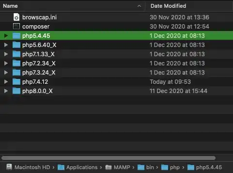

I'm using the free version of MAMP on mac (27 of April of 2021, MAMP version 6.3) and the @LiveSource answer helped me to find a solution.
My MAMP is not showing more than 2 option on the dropdown and on the /Applications/MAMP/bin/php has 7 options of PHP version. So the MAMP will display the latest 2.
To solve it I changed the name of all PHP version folders that I would not like to use. This way only 2 folders will be compatible with MAMP and my desired versions will display on the dropdown.
I added a _X in the end but you can add anything.
After doing the change, close the MAMP and open it again.
See the screenshots of the solution working.
