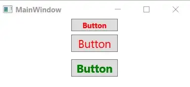

Use AttachedProperty to set multiple styles like following code:

Usage: (Point the xmlns:local="clr-namespace:style_a_class_like_css" to the right namespace)
<Window x:Class="MainWindow"
xmlns="http://schemas.microsoft.com/winfx/2006/xaml/presentation"
xmlns:x="http://schemas.microsoft.com/winfx/2006/xaml"
xmlns:d="http://schemas.microsoft.com/expression/blend/2008"
xmlns:mc="http://schemas.openxmlformats.org/markup-compatibility/2006"
mc:Ignorable="d"
Title="MainWindow" Height="150" Width="325">
<Window.Resources>
<Style TargetType="TextBlock" x:Key="Red" >
<Setter Property="Foreground" Value="Red"/>
</Style>
<Style TargetType="TextBlock" x:Key="Green" >
<Setter Property="Foreground" Value="Green"/>
</Style>
<Style TargetType="TextBlock" x:Key="Size18" >
<Setter Property="FontSize" Value="18"/>
<Setter Property="Margin" Value="6"/>
</Style>
<Style TargetType="TextBlock" x:Key="Bold" >
<Setter Property="FontWeight" Value="Bold"/>
</Style>
</Window.Resources>
<StackPanel>
<Button Content="Button" local:Css.Class="Red Bold" Width="75"/>
<Button Content="Button" local:Css.Class="Red Size18" Width="75"/>
<Button Content="Button" local:Css.Class="Green Size18 Bold" Width="75"/>
</StackPanel>
</Window>
Result:

Then for the xaml:
<Style x:Key="Style1" TargetType="Button">
<!--setters here-->
</Style>
<Style x:Key="Style2" TargetType="Button">
<!--setters here-->
<Setter Property="FontStyle" Value="Italic" />
</Style>
<v:MultiStyle x:Key="MergedStyle">
<Style BasedOn="{StaticResource Style1}"/>
<Style BasedOn="{StaticResource Style2}"/>
</v:MultiStyle>
Then you use it in your element (a button in this instance)
<Button Style="{StaticResource MergedStyle}" Content="Hello World"/>
And you can use it as base for a new style like so (make sure you declare the merged style before the one inheriting it)
<Style x:Key="DerivedStyle" TargetType="Button" BasedOn="{StaticResource MergedStyle}">
<Setter Property="Background" Value="Red"/>
</Style>
