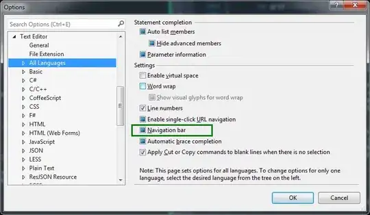

Does anyone know how to get my class name and method name dropdown lists again? It's the dropdown lists that are usually above the code. It's just a setting but i can't seem to find it. I don't want to reset my setting btw. I shouldn't have to.

haha, yeap, exactly, I spent like 10min in a new VS installation to find how to disable it :D such a waste of vertical space... – mikus Jul 03 '14 at 21:10
1Fixes bug in Visual Basic 2015 on Azure VM. – Doug Null Dec 26 '15 at 13:50
1Was checked under "All Languages" had to check in "Basic" to make it appear. – Bernhard Döbler Mar 05 '16 at 20:46
1Spent 10 minutes in new VS install trying to enable this. Best short functionality in VS!!! – htm11h Nov 04 '17 at 13:22
This is still a "feature" in VS2019. If the class and method dropdowns are missing, toggle the Navigation Bar setting on/off/on and it should re-appear. – robnick Feb 27 '20 at 03:39
Still the answer for VS 2022 17.4.3 – AC Thompson Dec 18 '22 at 03:37
Tools - Options - Text Editor - (choose the type of file - C#, html, etc) - General
In the bottom section of the form (The "Display" area) make sure that "Navigation Bar" is checked.

In VS2015 I just had to toggle this setting off then back on again to get the navigation bar back.

Make sure you in code behind file.
In my case I was looking at code (VB) server side code inside .aspx page, and the dropdown only for code behind files (.aspx.vb or aspx.cs)
