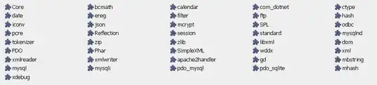

You are not loading the php_imagick.dll extension.
Check first of all that the file is there and is readable. If it is, then it is not loading because the DLL itself requires some other DLL; this error isn't usually shown by Windows. You will need some tool such as DEPENDS to load php_imagick.dll and see what unresolved externals it contains.
You will probably find that some functions are imported by a library (such as libeay32.dll) that is maybe associated with an extension you did not load, or is in the PHP directory but ought to have been copied into Windows' SYSTEM directory, or maybe uses a different VC runtime (e.g MSVCR90.DLL).
