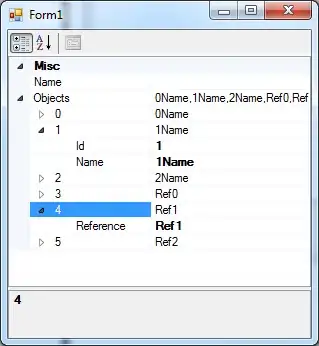

I have two classes that I am using to dynamically add objects to the propertyGrid bound list in the form of properties. The first(CustomClass) can be downloaded here. It is used to Dynamically create properties. The second class(DisplayIEnumerable) I am using is derived from the first and can be found here.
The DisplayIEnumerable class loops through the list objects and adds a property to itself with the information contained within the each object. A DisplayClass is passed in to define exactly how those objects properties should be represented within the Grid.
Up to this Point everything works great! as evidenced by this picture(picture was not created using the classes provided, Strings are formatted differently in the classes I am using, removed formatting code to help you focus on the relevant code:
