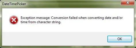

NOTE: If you are planning to insert Date only data to a date column type in SQL, see this documentation related to the supported String Literal Formats for date. You can not insert a date in the format string ydm because is not supported:
dateTimePicker1.CustomFormat = "yyyy/dd/MM";
var qr = "INSERT INTO tbl VALUES (@dtp)";
using (var insertCommand = new SqlCommand..
try
insertCommand.Parameters.AddWithValue("@dtp", dateTimePicker1.Text);
con.Open();
insertCommand.ExecuteScalar();
catch (Exception ex)
MessageBox.Show("Exception message: " + ex.Message, "DateTimePicker", MessageBoxButtons.OK, MessageBoxIcon.Error);
the above code ends in the following Exception:
Be aware. Cheers.
