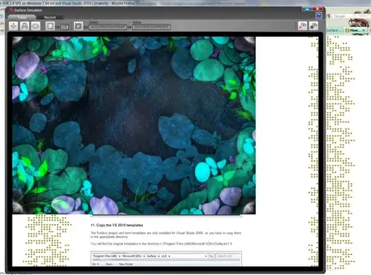

- The PixelSense/Surface 1.0 simulator is the only possibility of running Surface 1.0 applications on a desktop computer. This simulator is not very well usable, and downright buggy on some systems: On my computer, it appears like this:
(The output covers only some 3/4 of the simulator window, but the input is registered in the whole window. i.e. to click on the bottom right corner of the Surface simulation, I have to click into the (apparently transparent) bottom right corner of the simulator window.)
