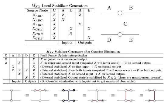

In the ZX calculus, the closest thing to a graph that measures an observable is a graph that post-selects that observable to be in its $+1$ eigenbasis.
If you are attempting to understand a surface code lattice surgery computation in terms of a ZX graph this is kind of annoying. You need to be able to figure out which postselections are just shorthands for unitary effects, and which ones are actual measurements of the inputs. The best way that I know of to do that is to perform Gaussian elimination on the table of things that are post-selected by each individual spider. The eliminated table then tells you the external observables that are postselected. Any observable that is input-only or output-only indicates the presence of a measurement.
