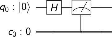

Classical computers are inherently deterministic, so they either generate pseudorandom numbers, or use an external physical process with statistically random noise to generate random numbers.
Quantum computers are inherently probabilistic, so generating true random numbers is very natural for them. Quantum random number generators are already on the market (e.g., IDQ).
This circuit
Quantum_RNG
generates 0 or 1 on $c_0$, both with probability 0.5. Using $n$ quantum and classical registers configured identical to those above would randomly generate a number between $0$ and $2^n-1$.
In the circuit above, the Hadamard gate ($H$) transforms the qubit from a known state $\vert 0 \rangle$ to a superposition of states described by
$$H \vert 0 \rangle = \frac{\vert 0 \rangle + \vert 1 \rangle}{\sqrt{2}}.$$
If the Hadamard gate was removed, i.e. no superposition, there would be no randomness in the output since the measurement would read $\vert 0 \rangle$ every time (apart from noise).
More complicated circuits can be built to do more interesting sampling tasks, but I'm not sure what you are looking for specifically. This talk goes into more detail on the subject.
If you are new to quantum computing, you might need to work through a good textbook on the subject (the standard text is Nielson and Chuang) before any of this will make much sense.
