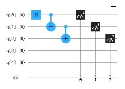

Here is a circuit for preparation of state $\frac{1}{\sqrt{2}}(|000\rangle + |111\rangle)$.
GHZ state

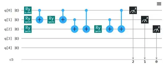

And here one for state $\frac{1}{\sqrt{3}}(|001\rangle + |010\rangle+ |100\rangle)$
W state
