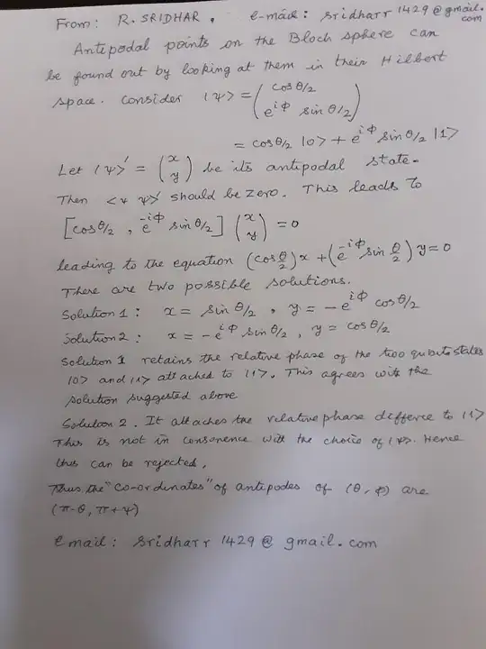

Attaching my answer for finding the antipodal points on the Bloch sphereution in an alternate way
