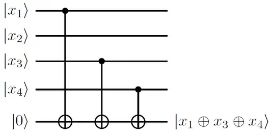

Let's express this slightly differently. You need a unitary operation that implements $$ |x\rangle|0\rangle\mapsto |x\rangle|H_1x\rangle. $$ I'm not saying this is necessarily the best way of doing it (there will be far more insightful strategies), but you could certainly write this out for all possible values of $x$. As such, you'd be able to write out the matrix operation corresponding to the unitary. The point is that this must work for every input $x$, not only for the $x+y+e_1$ that is relevant to you at a specific moment.
If you now want a more reasonable strategy to approach this calculation, just think about calculating a single bit of the ancilla, corresponding to a single row of the parity check matrix. What calculation is it you're actually performing? What does a 1 in the parity check matrix tell you? (bitwise addition of all the bits in $x$ where the corresponding bit value in the row is 1). Controlled-not is great at performing bitwise addition between the two inputs, writing the output on the target qubit.
Let's imagine the first row of the parity check matrix is $(1,0,1,1)$. There are 4 bit values, so we have $x=(x_1,x_2,x_3,x_4)$. Hence the inner product between the two just gives $x_1\oplus x_3\oplus x_4$. How do we compute this value with a quantum circuit?enter image description here
