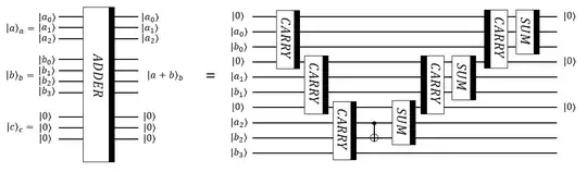

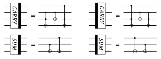

3-qubit addition circuit ADDER. We will use circuits CARRY and SUM which implement bitwise carry and sum operations. CARRY and SUM Note that thick black line on the right side of a block denotes operation itself, while thick black line on the left side of a block denotes reverse operation, i.e. operation with reverse order of all elementary operation for the block.
CARRY and SUM are used to construct 3-qubit addition transformation ADDER ADDER Note that $a$ is the number decoded with 3 qubits, $b$ is the number decoded with 3 qubits, but the register $|b\rangle_b$ contains additional qubit to account for the possibility of 4-bit result of addition.

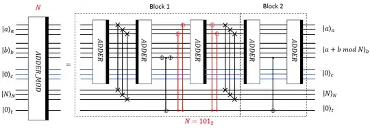

3-qubit modular addition circuit ADDER_MOD. Modular addition has two blocks: Block 1 and Block 2. ADDER_MOD The logic of the Block 1 is the following: firstly, ADDER acts $$|a\rangle_a |b\rangle_b |0\rangle_c |N\rangle_N |0\rangle_t \rightarrow |a\rangle_a |a+b\rangle_b |0\rangle_c |N\rangle_N |0\rangle_t$$ Then 3 SWAP gates swap the register $a$ with the register $N$: $$|a\rangle_a |a+b\rangle_b |0\rangle_c |N\rangle_N |0\rangle_t \rightarrow |N\rangle_a |a+b\rangle_b |0\rangle_c |a\rangle_N |0\rangle_t$$ Then reverse ADDER extracts $N$: $$|N\rangle_a |a+b\rangle_b |0\rangle_c |a\rangle_N |0\rangle_t \rightarrow |N\rangle_a |a+b-N\rangle_b |0\rangle_c |a\rangle_N |0\rangle_t$$ At that point we are interested in the sign of $a+b-N$. If it is greater than 0, we want to keep the result in the register $b$, but if it is less than 0, we want to make addition of $N$ once again to get $a+b$ in the register $b$, and this is why see CNOTs, the third ADDER and SWAPS in the rest of Block 1.
Note that CNOTs denoted by red color are there to make transformation $|N\rangle_a\rightarrow |0\rangle_a$ before ADDER if the value of register $t$ is $|1\rangle_t$, and then undo this operation after ADDER. This is the first time when classically known N affects configuration of the circuit itself: in the case of $N=5=101_2$ we need 2 CNOTs before ADDER and 2 CNOTS after ADDER, but if $N=6=111_2$, we would have to use 3 red CNOTs before ADDER and 3 red CNOTS after ADDER.
The role of the Block 2 is to uncompute the value $|1\rangle_t$ to $|0\rangle_t$, if it appears.

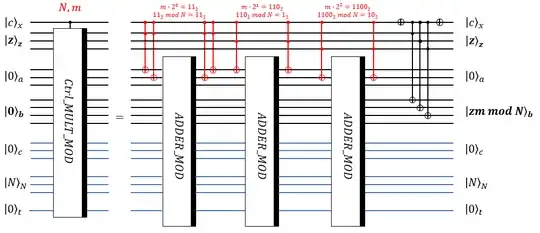

3-qubit controlled modular multiplication circuit Ctrl_MULT_MOD. Block Ctrl_MULT_MOD implements the following transformation: $$|c\rangle_x |z\rangle_z |0\rangle_a |0\rangle_b |0\rangle_c |N\rangle_N |0\rangle_t\rightarrow |c\rangle_x |z\rangle_z |0\rangle_a |zm \mod{N}\rangle_b |0\rangle_c |N\rangle_N |0\rangle_t, \text{ if } c = 1$$ $$|c\rangle_x |z\rangle_z |0\rangle_a |0\rangle_b |0\rangle_c |N\rangle_N |0\rangle_t\rightarrow |c\rangle_x |z\rangle_z |0\rangle_a |z\rangle_b |0\rangle_c |N\rangle_N |0\rangle_t, \text{ if }c=0$$ For this particular block we use $m=3=11_2, N=5=101_2$ Ctrl_MULT_MOD The role of red Toffoli gates is to replace zeros in the register $|0\rangle_a$ with the state $|m\times z_i 2^ \mod{N}\rangle_a$ to further add up all this numbers to get $|z\times \mod{N}\rangle_b$. Red Toffoli gates put values $m\times 2^i \mod{N}$ in the register $a$ conditionally on values in registers $x$ and $z$. Note that numbers $m\times 2^i \mod{N}$ can be classically and efficiently computed. Also note that this is the second time when classically known information affects configuration of the circuit itself.
The last block of CNOTs is used to put value $z$ in the register $|0\rangle_b$ if control $|c\rangle_x$ is $|0\rangle_x$

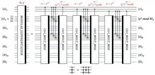

3-qubit modular exponentiation circuit MODULAR_EXPONENTIATION. Finally, using an array of controlled modular multiplications, we can implement modular exponentiation using known classical information for every step. It should be a succession of controlled modular multiplications with controls set on wires of the register $x$. But every Ctrl_MULT_MOD should be accompanied by SWAPs and reverse Ctrl_MULT_MOD to reset one of the registers to zero and free it for the next controlled modular multiplication (see the original paper for more details). Notation $(...)^{−1}\mod{N}$ is for modular inverse, which can be efficiently classically precomputed using Euclid’s algorithm.
To sum up, this Ctrl_MULT_MOD blocks implement the following chain of transformations which lead to the desired result: $$|x\rangle_x |1\rangle_z |0\rangle_a |0\rangle_b |0\rangle_c |N\rangle_N |0\rangle_t\rightarrow |x\rangle_x |1\times y^{x_0 2^0}\mod{N}\rangle_z |0\rangle_a |0\rangle_b |0\rangle_c |N\rangle_N |0\rangle_t \rightarrow$$ $$\rightarrow |x\rangle_x |1\times y^{x_0 2^0}\times y^{x_1 2^1}\mod{N}\rangle_z |0\rangle_a |0\rangle_b |0\rangle_c |N\rangle_N |0\rangle_t \rightarrow... \rightarrow$$ $$\rightarrow |x\rangle_x |y^x\mod{N}\rangle_z |0\rangle_a |0\rangle_b |0\rangle_c |N\rangle_N |0\rangle_t,$$ MODULAR_EXPONENTIATION
The last thing I want to mention is that if the size of the register $|N\rangle_N$ is n, then the size of the register $|x\rangle_x$ should be $2n$ to make MODULAR_EXPONENTIATION circuit usable in Shor's algorithm. As one can see from the last picture, going to $2n = 6$ qubits in $|x\rangle_x$ for this particular case requires just additional 3 wires for $|x\rangle$ and additional 3 blocks of [Ctrl_MULT_MOD - SWAPs - inverse Ctrl_MULT_MOD].
Regarding your question about changes which occur when we go from $11^x \mod{15}$ to $7^x \mod{21}$: for $N=15$ we need 4 bits to encode this number, so the current architecture requires 8 or less qubits for the register $x$, 4 qubits for the register $z$, 4 qubits for the register $a$, 4+1 qubits for the register $b$, 4 qubits for the register $c$, 4 qubits for the register $N$ and 1 qubit for control $t$. If we use $N=21$, then it will be 10 or less qubits for the register $x$, 5 qubits for the register $z$, 5 qubits for the register $a$, 5+1 qubits for the register $b$, 5 qubits for the register $c$, 5 qubits for the register $N$ and 1 qubit for control $t$. So one can see that number of qubits grows as $O(n)$, which is acceptable according to the original paper

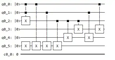

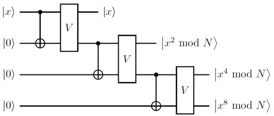

Here's, surely, a very non-optimal way of doing it. Imagine we have a unitary $V$ which performs the operation $$ V|x\rangle|y\rangle=|x\rangle|xy\text{ mod }N\rangle. $$ We can deal with how $V$ might work separately, but if you have that, we want to see how we can use it to calculate any $|x^{2^i}\text{ mod }N\rangle$. The trick is that if both inputs are $x^{2^j}\text{ mod }N$, then the output is $x^{2^{j+1}}\text{ mod }N$, so we only have to repeat this construction $i$ times. For example, in the circuit below: enter image description here Here, I've used the control-not to denote transversal application to achieve copying of one (effectively classical) register to another. This lets you do any of the $U$ operations that you need, assuming that you know how to implement $V$. Don't forget that, as part of a larger circuit, you have to 'uncompute' the data on any auxiliary registers.
So, how do we implement $V$? Let me give some of the components. Let $x=x_1x_2x_3\ldots x_n$ and $y=y_1y_2\ldots y_n$ be the binary representations of $x$ and $y$. The product $xy$ is easy to calculate by long multiplication. For example, $x_iy_j$ is a bit value (so there are never any carries from the multiplication steps) that is equivalent to applying the Toffoli (controlled-controlled-not) with $x_i$ and $y_j$ as the two inputs. So you can calculate $y_1x$, $y_2x$, $y_3x\ldots$ on separate registers and then add them up.

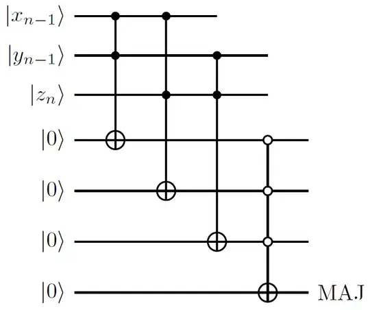

Addition is another standard circuit. Imagine you want to add $x_1x_2\ldots x_n$ and $y_1y_2\ldots y_n$. We need to have additional two registers: one for the output, one for the carry bit. The least significant bit of output is $x_n\oplus y_n$, which can be calculated with controlled-nots. The carry bit has value $z_n=x_ny_n$. The next output is $x_{n-1}\oplus y_{n-1}\oplus z_{n}$, which we can again do with controlled nots. The carry bit is a majority vote - are two or more of $x_{n-1},y_{n-1},z_n$ value 1? One way to implement this is: enter image description here You can keep repeating this process bit by bit to compute the sum. Then, again, don't forget to uncompute all the ancillas.

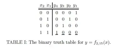

The method of transversal copying by a CNOT is solid and you can stack up the building blocks for the quantum part of shor algorithm. However ad-hoc circuit synthesis based at a pattern of the function truth table could be efficiënt in some cases as described in arxiv 1310.6446v2. First case is for factoring N=15 and base a = 2 with period r = 4. In exponential formulation we have $$f(x)=a^{x}\text{ mod }15 $$ With values
input x
Setup a truth table for input x between 0 and 3. Input x is represented by 2 qubits x2 and x1. Output y is represented by 4 qubits y4,y3,y2,y1 For example if x = 2 then x2=1 and x1=0 then only y3 =1 so put a NOT on this line.
Furthermore underlined entries in table 1 are the ones that are modified by a toffoli gate to get the right output in the circuit according the table 1. We can use this module in the overall algorithm according to https://arxiv.org/pdf/0705.1398.pdf
