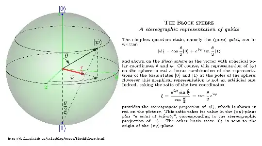

The Bloch sphere is homeomorphic to the Riemann sphere, and there exists a stereographic projection $\Bbb S^2\to \Bbb C_\infty$. But this only holds for pure states. To quote Wikipedia:
Quantum mechanics is mathematically formulated in Hilbert space or projective Hilbert space. The space of pure states of a quantum system is given by the one-dimensional subspaces of the corresponding Hilbert space (or the "points" of the projective Hilbert space). For a two-dimensional Hilbert space, this is simply the complex projective line $\Bbb C P^1$. This is the Bloch sphere.
Essentially the set of all possible pure states of a qubit is homeomorphic to $\Bbb C P^1$.

Almost. You get a manifold with boundary with the Bloch ball. The radius from the origin parameterizing how pure it is. The origin being maximally mixed. This isn't a manifold because a point on the boundary has a neighborhood that is homeomorphic to a half space but not one homeomorphic to $\Bbb R^n$.
