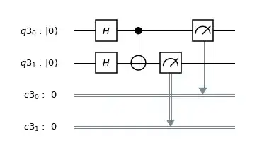

Suppose we have the quantum circuit below with a quantum register of 2 qubits and a classical register of 2 bits. The Hadamard gates and CNOT gate are not important for the question. When we measure a qubit we collapse it into one of the computational basis states (let's suppose we are working with the basis $ \{|0\rangle,|1\rangle\}$). But on Nielsen and Chuang's book, it says
...this operation [measurement] converts a single qubit state $|\psi \rangle=\alpha |0\rangle +\beta |1\rangle$ into a probabilistic bit $M$ (...) which is $0$ with a probability of $|\alpha|^2$, or 1 with a probability of $|\beta|^2$.
Now here's what I don't understand:
  1. If the measurement is an irreversible process then the probability of the resultant state is towards the initial quantum state it was in, that is, if the resultant state is $1$ with a probability of, say, $63\%$, that means that is has a $63\%$ probability that the initial state was $|\psi \rangle= |1\rangle$. However, after it has collapsed to a bit, then, there is no probability associated with it, it certainly is $1$ for all future measurements, it shouldn't be a probabilistic bit.
  2. In the circuit below, what is the need of registering the state of the qubit in a classical bit if it has collapsed irreversibly into that same state? Does it only make sense to do so when it is the end of the circuit?

I believe the word in the term that's confusing you is "converts". I'd say don't overthink this. They simply mean that on measurement of a qubit in the state $a|0\rangle + b|1\rangle$ there $|a|^2$ probability of getting $|0\rangle$ and $|b|^2$ probability of getting $|1\rangle$. The term "probabilitic bit" here is simply an abstraction. They mean that upon measurement you can imagine your qubit to be a "bit" with a value of either 0 or 1. That is, it has the value 0 with probability $|a|^2$ and value 1 with probability $|b|^2$. But this is assuming they don't know the measurement result yet. They're simply mathematically modelling the measured qubit as a probabilitic bit without the knowledge of the result of the measurement. Of course, if you know the result of the measurement it's going to be either 0 or 1 with $100\%$ probability.
This is already answered in Why do we need a Classical Register for carrying out Quantum Computations?
The results of the measurements are basically classical information i.e. 0 or 1 if you're measuring in the $\{|0\rangle, |1\rangle\}$ basis. Remember that in reality you're measuring things like electron spin. You need to store that classical information somewhere for future use, and that is what copying the results of the measurement to the classical bits achieves. And yes, in the gate model it's generally done after the measurements (which is usually the final step of a quantum algorithm).
