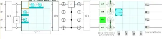

Grover with W4 and W4 conjugate transpose
A much better algorithm is the one described by this circuit enter image description here
The idea is pretty similar to the original Grover algorithm. Basically, you apply the conjugate transpose of the W4 state (and in the general case, the conjugate transpose of whatever you have applied to obtain the initial state of the Grover's algorithm). In this way, you have a non zero probability of obtaining the all zero state, which in this case is $$|0000\rangle$$. Then, you invert about this state and reapply the W4 state. In this case, because we starts with 4 possible answers, the Grover's algorithm works 100% of the time.
