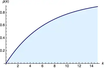

If you limit yourself to Q12 and Q13 then the CX gate between the two has a probability of failure of 0.041. This means that applying only CX gates, you have a probability of success of $(1 - 0.041)^n$ with $n$ being the number of CX gates applied. For $10$ CX gates, the probability is $\approx 0.66$. For $20$ gates, the probability of success drops to $\approx 0.43$.
