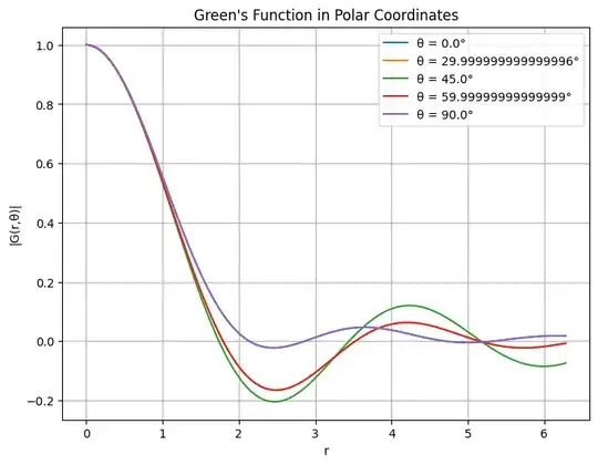

and I implement his suggestion . the visualization for Normal Green's function enter image description here

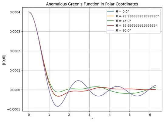

and for Anomalous Part enter image description here

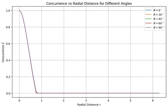

I see that for some specific values of $ \theta $, the normal Green's function $ G $ and the anomalous Green's function $ F $ are different. However, the concurrence appears to be the same for all of them.
and I have used these formula for compute the concurrence
$$f(r) = \frac{F(r)}{G(0)}$$ $$g(r) = \frac{G(r)}{G(0)}$$
  • $ G(0) $ is the Green’s function at $ r = 0 $.
Compute $ p(r) $
$$ p(r) = \frac{f^2 + g^2}{2 + f^2 - g^2} $$
Compute the concurrence $ C(r) $
$$ C(r) = \max\left(0, \frac{3p - 1}{2}\right) $$ I did not observe any convexity or concavity in my concurrence, and I did not see any differences in concurrence for these values of . However, the Green's functions differ for different .
Does anyone know why using the flatten method in Python to convert a 2D Green's function to 1D ruins my problem? Also, why does the concurrence remain the same for all $ \theta $ when I use polar coordinates, even though the Green's functions differ for different $ \theta $?
