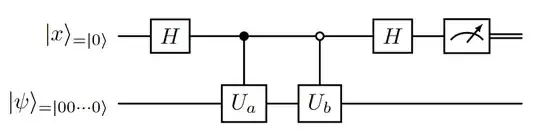

I think Evgenyi and Tristan were on to it - you just need to close the interference and post-select the ancilla control.
In particular, let $U_a$ be the depth-$D$ circuit that prepares $|a\rangle$ from the $N$-qubit all-zero's ket, and let $U_b$ be the depth-$D$ circuit that prepares $|b\rangle$. Let $|x\rangle$ be a control ancilla initialized to $|0\rangle$.
If the $ND$ gates from which $U_a$ are composed and the $ND$ gates from which $U_b$ are composed are independent and identiclally distributed, and if the depth $D$ is polynomial in $N$, then we can say with some confidence that $\mathfrak R\big(\langle b|a\rangle\big) \approx 0$. I'm pretty sure this follows from some arguments about approximate t-designs (whatever those are).
Hence the circuit below prepares a state $\epsilon$-close to $\frac{|a\rangle+|b\rangle}{\sqrt 2}$ if we post-select on the ancilla reverting back to $|0\rangle$ after measurement. The ancilla reverts to $|0\rangle$ with about 50% probability, and Chernoff's bound tells you that you only need to run this circuit a handful of times before you are confident that you'll get $|0\rangle$ soon enough.
Preparing equal superposition of |a\rangle and |b\rangle
Assuming you did post-select on the ancilla reverting back to $|0\rangle$, the total depth, including both slices of the Hadamard bread between the $U_a$ and $U_b$ filling, is $2ND+2$ (or $2ND+3$ if you consider the measurement of the ancilla as another layer).
