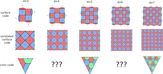

The surface code comes in both odd-distance and even-distance forms. Color codes always seem to come in odd-distance. Presumably this is due to the fact that the X and Z observables overlap at the boundary of a color code, and they must anticommute, forcing an odd boundary length. But is this actually a constraint, or are there ways to get nice even-distance color codes? What if implicit assumptions are dropped, like planar vs toric topology or the usage of two-color-type boundaries instead of pauli-type boundaries?

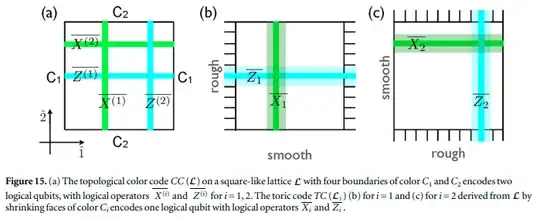

Color codes on a torus or with boundaries of two colors (as you suspected) that encode 4 and 2 logical qubits respectively can have even distance. For a general view on that, see for example
"Unfolding the color code" Fig. 15 (https://iopscience.iop.org/article/10.1088/1367-2630/17/8/083026/pdf), or
the boundary section of "The boundaries and twist defects of the color code and their applications to topological quantum computation" (https://quantum-journal.org/papers/q-2018-10-19-101/pdf/).

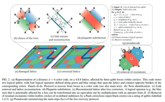

To my knowledge, there hasn't been done much work on concrete examples, but e.g.
Fig. 2 in "Twins Percolation for Qubit Losses in Topological Color Codes" (https://arxiv.org/abs/1802.04545),
shows a distance 6 planer color code.

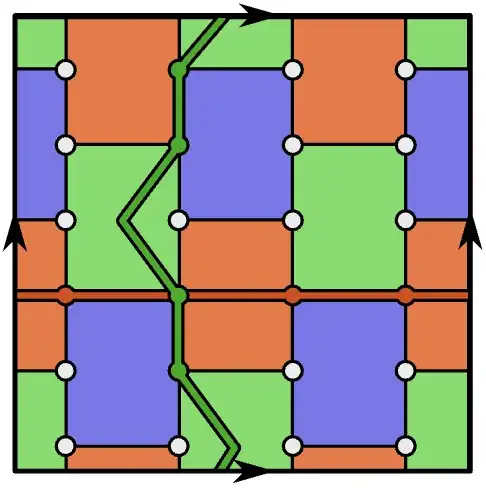

You are probably aware of color codes layed on a torus that have an even distance. The question is then: can we find an even distance color code that encodes only one qubit?

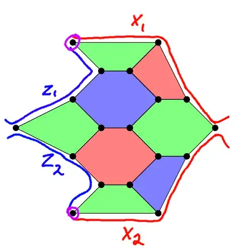

One way to get an even distance color code is by making a square patch that alternates between GB and RG boundaries on its sides. This has two logical qubits instead of one. For example, here is an [[18, 2, 4]] color code:
