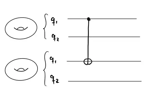

My question is the following: Can I do more "targeted" CNOT gates on CSS codes. For example, the toric code encodes two logical qubits $q_1$ and $q_2$. Can I transversally apply a CNOT between two copies of the toric code, but only the CNOT between one qubit in the first code and one in the second one? Here a very informal drawing:
One naïve idea would be to apply CNOT between qubits involved in the corresponding logical $X$ operator, but for the toric code, it doesn't seem to preserve the stabiliser group.

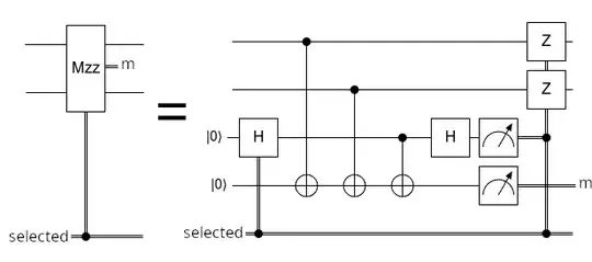

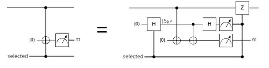

Expanding on DaftWullie's answer: it is sufficient to prepare "selection states".
Suppose you can prepare a "selection state" $|S_k\rangle$ where all the logical qubits are $|0\rangle$, except for the logical qubit with index $k$ which is in the state $|+\rangle$. You can use this state to mask out effects so they apply to that one qubit. And that kind of opens up the world.
For example, if you want to measure one qubit $k$, you can do that by consuming a copy of $|S_k\rangle$ using block-transversal CNOTs, Hs, and measurements (as well as non-block-transversal Pauli feedback in the control system). This is the selective measurement:
The key thing here is that the only gates controlled by the "selected" line are the CH at the start (representing preparation of the selection state) and the Pauli feedback at the end (which is easy to do non-transversally).
Selective measurement easily generalizes to selective parity measurement:
Once you have selective parity measurement, you can make the selective CNOT via lattice surgery. The selective CNOT gives you the selective swap. The selective swaps gives you everything, via selective temporarily-swap-to-an-ancillary-patch-and-do-the-gate-there.
So this has at least reduced the problem of doing selective gates to the problem of preparing these selection states. I suspect you can do that by preparing noisy versions, then doing some kind of state distillation, then using existing copies to catalyze the production of more copies.

As you say, when people talk about these transversal gates, they typically mean a physical transversal application, resulting in transversal logical application. Whether you can localise it to qubits depends on your code (and typically costs you one level of the Clifford hierarchy).
In particular, we always start with the ability to to individual Paulis in a transversal manner. Imagine we could do individual $S$ gates as well. This would give us the power to convert transversal $H$ into individual $H$ gates, using the identities $H^3=H$ and $(SH)^3=I$. (In other words, apply transversal $H$ 3 times. On qubits where you don't want to apply $H$, use your individual $S$ after each $H$.) I can also make individual c-Z because $X^2=I$ and $SXS^\dagger X=Z$, then replace $X$ with controlled-not.
If I don't have individual $S$, I can make it if I have transversal $T$, using $TXT^\dagger X=S$ and $TT^\dagger=I$, thereby converting the individual $X$ control into individual $S$.
There are other tricks that you can perform. For example, if you can prepare individual logical ancillas (in $|+\rangle$ states or $|0\rangle$) states (this is individual Pauli measurement, which isn't transversal), you can convert transversal $S$ + transversal cNOT into local $S$. This is basically gate teleportation.
For the Toric code, we don't have enough available to get started with any of these tricks.
