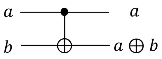

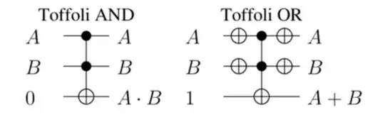

Quantum computers can simulate different logical systems that are used in Classical Computers, but the effectiveness of the simulation depends on the problem at hand. With the help of X, CNOT, CCNOT quantum gate and some ancilla qubit, classical NOT, AND, OR and XOR gate can be implemented.
