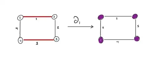

The repetition code can be written as a chain complex $$ C_1 \xrightarrow{\partial_1} C_0, $$ For example for the distance 4 repetition code $$\partial_1= \pmatrix{1 & 1 & 0 & 0 \cr 0 & 1 & 1 & 0 \cr 0 & 0 & 1 & 1 \cr 1 & 0 & 0 & 1} ,$$ and $C_1$ is a vector space over $\mathbb{Z}_2^{4\times 1}$ and $C_0$ is a vector space over $\mathbb{Z}_2^{4\times 1}$
Elements in $C_1$ can be understood as a set of edges and elements in $C_0$ as sets of vertexes. The boundary operator $d_1$ is a map from a set of edges to a set of vertexes. For example for edges $c_1 =\pmatrix{1 0 1 0}$, $\partial_1 c_1 = \pmatrix{1,1,1,1}$. The graphical interpretation of this is: enter image description here
