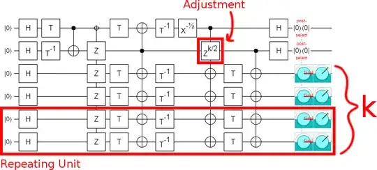

I don't know the answer to your question, but I think I know something relevant. The space of codes with transversal T gates has relationships to the space of circuits that can distill T states. And the distillation circuits don't all look like "and then I apply a big layer of T gates to all qubits leaving out none of them".
The T state distillation circuit I know that uses the fewest non-Clifford gates is one that originally came from block codes but I don't know if it corresponds to a code anymore. It consumes 10 T states with error rate $p$ and produces 2 T states with error rate $O(p^2)$. It's part of a family of circuits that limit to a 3:1 conversion ratio:
So the smallest circuits don't particularly look like codes with strongly transversal T gates. I dunno if that says anything about Reed-Muller codes specifically, but I'd expect the smallest code with a constant depth $\sqrt{T}$ to be something very weird looking.
