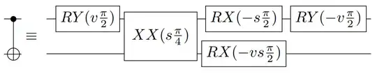

Morever, in the paper arXiv:1603.07678, they show that the $CNOT$ operation can be implemented, up to a global phase, by the following sequence of gates (setting $v=s=1$):

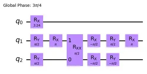

In Qiskit, the XX interaction is implemented by the RXX gate. So, to complete step 3 of the algorithm, you can simply use the Qiskit transpile function as follows:
from qiskit.circuit.random import random_circuit
from qiskit import transpile
qc = random_circuit(3, 1, seed=5) tqc = transpile(qc, basis_gates=['rx', 'ry', 'rz', 'rxx', 'id']) tqc.draw(output='mpl')

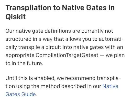

I found a guide specific to Qiskit linked by the Native Gate Guide you provided. In the section “Transpilation to Native Gates in Qiskit”, it states that transpiler a circuit into a native gate set is not supported at the moment.
