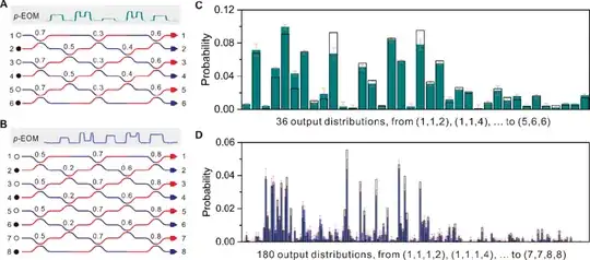

Boson sampling is a computation that is not doable on classical machines but quite doable on quantum photonic machines.
(https://www.researchgate.net/figure/Experimental-results-for-3-and-4-boson-sampling-A-B-The-equivalent-3-and-4-boson_fig2_301872712)
The precise generated pattern at the end of the board will take impossibly long to compute/simulate on classical machines.
