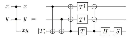

How can I calculate CNOT gate with 1 control and 2 target qubits as matrix?
To understand how to construct the $CNOT$ gate with 1 control and 2 target qubits as a matrix, we'll first look at how the regular 2-qubit $CNOT$ gate is constructed and then use the same technique to construct the gate in question. If you're just interested in the answer feel free to scroll to the bottom and look at the final matrix :)

Notice that you can view $CNOT_{1,2}$ as a tensor product $X_2 I_3$ controlled by qubit 1: $$ CNOT_{1,2} \otimes I_3 = C_1(X_2 I_3) $$ The same applies to $CNOT_{1,3}$. You can then get the matrix for the controlled $X_2 X_3$ gate by multiplying the two $CNOT$ matrices: $$ C_1(X_2 X_3) = C_1(X_2 I_3) C_1(I_2 X_3) $$ Here, the control qubit is 1, but if you want your qubits in arbitrary order like in circuit you have above, refer to this answer.
