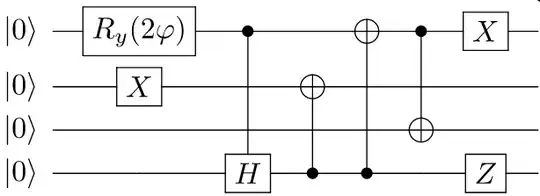

I need to rewrite a following circuit from Cirq to Qiskit with $2\varphi = \pi$.

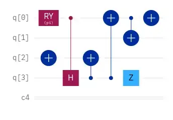

It's a circuit representing an initial state for VQE calculation. Considering, that qiskit_nature considers a different ordering of spin-orbitals (first all spin-up, then all spin-down), I've rewritten the circuit like this (switching 1st and 2nd qubit, indexing from 0):
In both cases the statevector equals to

, i.e.
$$ \left|\psi\right> = \frac{1}{\sqrt{2}}\left| 0110 \right> - \frac{1}{\sqrt{2}}\left| 1001 \right>. $$
In Cirq, the total angular momentum $\left<\psi \middle| S^2 \middle| \psi \right> = 0$, i.e. the state should be singlet. But when I try the same in qiskit with the help of second_q_ops(), I'm getting 1.999999....
Why does my result differ?

# Create circuit
qreg_q = QuantumRegister(4, 'q')
circuit = QuantumCircuit(qreg_q)
circuit.x(qreg_q[2])
circuit.ry(np.pi, qreg_q[0])
circuit.ch(qreg_q[0], qreg_q[3])
circuit.cx(qreg_q[3], qreg_q[2])
circuit.cx(qreg_q[3], qreg_q[0])
circuit.cx(qreg_q[0], qreg_q[1])
circuit.z(qreg_q[3])
circuit.x(qreg_q[0])
print(f'Circuit:\n{circuit}')
statevec = Statevector(circuit).data
print(f'Statevector:\n{statevec}')
