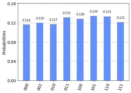

  1. Histogram of results
According to the truth table, the results should be ['000', '001', '011', '101']. Why does the algorithm not return the expected solutions?

This issue happens because $M \geq \frac{N}{2}$, where $M$ is the number of solutions and $N$ is the search domain size. For more details see this answer.
A workaround is to double the search domain by adding a dummy variable:

For you second example, 3 out of 5 solutions will be returned if the optimal number of iterations is used ($\Big\lfloor \frac{\pi}{4} \sqrt{N/M}\Big\rfloor$). You can get all the solutions by changing the number of iterations:
grover = Grover(iterations = 2, quantum_instance=quantum_instance)
Doing the same for the first example will not work (see the figure in this answer). However, doubling search domain should always work.
