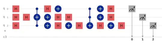

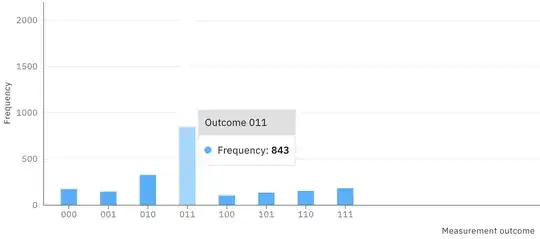

Thanks to @DaftWullie's comment. Here is my implementation of Grover's search for 110 on the IBM quantum platform Grover's search for 110 with outcome Outcome for Grover's search for 110

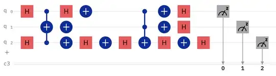

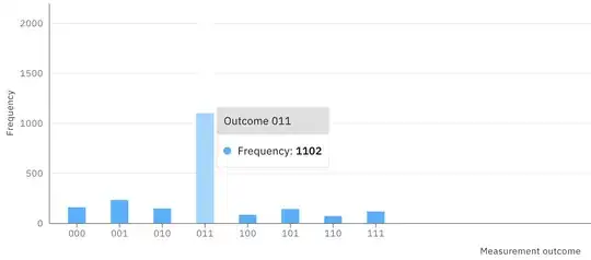

As DaftWullie said, the H gates around the decomposition of CCZ can be deleted for both ends, which brings us Grover's search for 110 With Less H Gates with outcome Outcome for Grover's search for 110 With Less H Gates
