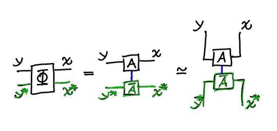

  4. Another way to understand the relations between Choi and Kraus representations, without getting bogged down with the indices and seemingly arbitrary relations, is using diagrammatic notation. You can simply observe the following: enter image description here where the leftmost image is a schematic representation of the channel, which is an object taking two inputs, one living in $\mathcal X$ and the other living in its dual $\mathcal X^*$, and corresponding outputs. Note that this notation is exploiting the isomorphism $\mathrm{Lin}(\mathcal X)\simeq\mathcal X\otimes\mathcal X^*$.
    The first identity is the Kraus decomposition: the blue line connecting the $A$ tensors corresponds to the $a$ index in the equations above. The rightmost picture corresponds to the Choi representation of the channel. Notice how the only thing we are doing is changing which wires we interpret as "inputs" and which ones we interpret as "outputs". The overall object never changes, we are just looking at it from different perspectives.
