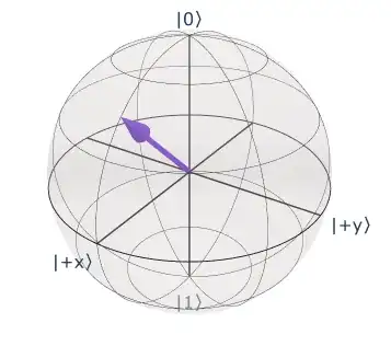

As mentioned in the other answer, the Hadamard gate is a pi rotation (180 degree) around the $X + Z$ axis. That is, it is a 180 degree rotation around the purple axis indicated in the below figure:
And the $Rx(\pi/2)$ follows by a $Rz(\pi/2)$ then follow by $Rx(\pi/2)$ does exactly this rotation as well.

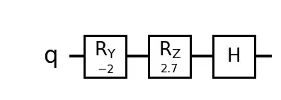

To have better visualization of this, suppose I start my qubit in the state $|0\rangle$ and I apply some rotation $U$ to it. Here, let's take $U$ to be: $U = \begin{pmatrix} 0.11833 - 0.52719i & 0.18429 - 0.82104i \\ -0.18429 - 0.82104i & 0.11833 + 0.52719i \\ \end{pmatrix}$
Which can be written as $U = R_Y(-2)R_Z(2.7)$. So we first apply $R_Y(-2)$ follow by $R_Z(2.7)$ then finally apply the Hadamard gate.

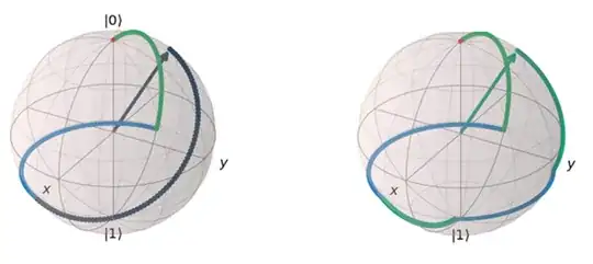

The reason to apply this $U$ is so that we get to a state that is non-trivial so we have better visualization of the rotation. In the animate below, the first two rotations correspond to the $R_Y(-2)$ then $R_Z(2.7)$. The last rotation correspond to the Hadamard rotation.
Keep an eye on the last rotation (Hadamard) as we will compare this to the rotation $Rx(\pi/2)$ follows by a $Rz(\pi/2)$ then follow by $Rx(\pi/2)$ next.

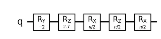

Here, we will consider the same starting point. That is, we again map start at the state $|0\rangle$ then apply $U = R_Y(-2)R_Z(2.7)$. But instead of applying the Hadamard gate, we will apply the rotations $Rx(\pi/2)Rz(\pi/2)Rx(\pi/2)$. That is,
So watch the last three rotations carefully. You can see that it reaches to the same final point as previously.
Side to side comparison:
