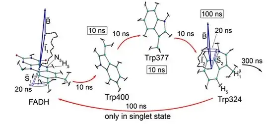

Forward reaction MFeffect
Figure 6. Shown here is a semi-classical description of the magnetic field effect on the radical pairs between FADH and tryptophan in cryptochrome. The unpaired electron spins (S$_1$ and S$_2$) precess about a local magnetic field produced by the addition of the external magnetic field $B$ with contributions I$_1$ and I$_2$ from the nuclear spins on the two radicals. The spin precession continuously alters the relative spin orientation, causing the singlet (anti-parallel) to triplet (parallel) interconversion which underlies the magnetic field effect. Electron back-transfer from a tryptophan to FADH quenches cryptochrome's active state. However, this back-transfer can only take place when the electron spins are in the singlet state, and this spin-dependence allows the external magnetic field, $B$, to affect cryptochrome activation.

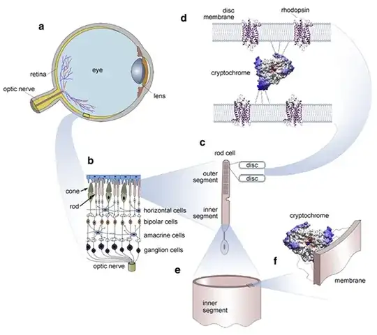

Retina Components
Figure 7. Schematic illustration of a bird's eye and its important components. The retina (a) converts images from the eye's optical system into electrical signals sent along the ganglion cells forming the optic nerve to the brain. (b) An enlarged retina segment is shown schematically. (c) The retina consists of several cell layers. The primary signals arising in the rod and cone outer segments are passed to the horizontal, the bipolar, the amacrine, and the ganglion cells. (d) The primary phototransduction signal is generated in the receptor protein rhodopsin shown schematically at a much reduced density. The rhodopsin containing membranes form disks with a thickness of ~20 nm, being ~15–20 nm apart from each other. The putatively magnetic-field-sensitive protein cryptochrome may be localized in a specifically oriented fashion between the disks of the outer segment of the photoreceptor cell, as schematically shown in panel d or the cryptochromes (e) may be attached to the oriented, quasi-cylindrical membrane of the inner segment of the photoreceptor cell (f).

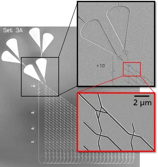

A biomechanical computer has been created. Bio4Comp, an EU-funded research project, have created biomolecular machines each only a few billionths of a meter (nanometers) in size. The actin-myosin and microtubule-kinesin motility systems can solve problems by moving through a nanofabricated network of channels designed to represent a mathematical algorithm; an approach we termed “network-based biocomputation”. Whenever the biomolecules reach a junction in the network, they either add a number to the sum they are calculating or leave it out. That way, each biomolecule acts as a tiny computer with processor and memory. While an individual biomolecule is much slower than a current computer, they are self-assembling so that they can be used in large numbers, quickly adding up their computing power. An example of how this works is shown in the video on their website.
WP4 SEM channels (full with scalebar corrected)

"The first step in solving mathematical problems with network-based biocomputation is to encode the problem into network format so that molecular motors exploring the network can solve the problem. We have already found network encodings for several NP-complete problems, which are particularly hard to solve with electronic computers. For example, we have encoded subset sum, exact cover, boolean satisfiability and travelling salesman.
Within the Bio4Comp project, we will focus on optimizing these encodings so that they can be efficiently solved with biological agents and be more readily scaled up. Analogous to optimized computer algorithms, optimized networks can greatly reduce the computing power (and thus the number of motor proteins) required for finding the correct solution." - Source: Bio4Comp Research.
