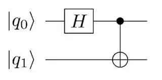

I know that in order to make a two quit entangled state, this quantum circuit is used: Hadamard + CNOT gate
But I was wondering if there are any other gate combinations which also create entangled two quit states.
If there are other quantum circuits which achieve this, I was wondering if they would also create any one of the four bell states. Thanks in advance.

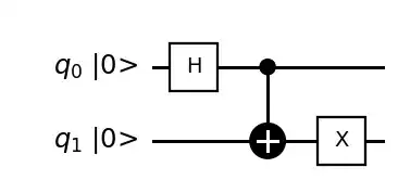

For instance, the following circuit
prepares the state $|\psi \rangle = \dfrac{|01\rangle + |10\rangle}{\sqrt{2}} $ which is another Bell state.

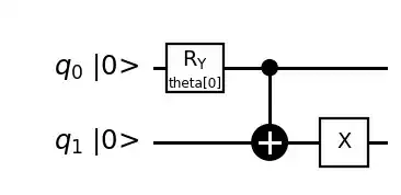

Note that if instead of using the Hadamard gate, $H$, I have replaced it with a $RY$ rotation then I would still generate an entangled state.
Since the above circuit will generate a state in the form $|\psi \rangle = \dfrac{ \alpha|01\rangle + \beta|10\rangle}{\sqrt{2}} $ where $|\alpha|^2 + |\beta|^2| = 1$. Also, note that at $\theta = \pi/2$, you get back the first circuit.
