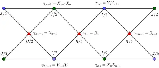

The method to obtain the tightest bound to date (for a generic short-range interacting model) is introduced in Ref1=arXiv:1908.03997. The basic idea is that the norm of the unequal time commutator $\|[A_X(t),B_Y(0)]\|$ between arbitrary local operators can be upper bounded by the solution to a set of first order linear differential equations living on the commutativity graph of the model. The commutativity graph, as introduced in Sec.II A of Ref1, can be easily drawn from the model Hamiltonian $\hat{H}$, and is designed to reflect the commutation relations between different local operators presented in $\hat{H}$. In translation invariant systems, this set of differential equations can be easily solved by a Fourier transform, and an upper bound of the LR speed can be calculated from the largest eigenfrequency $\omega_{\max}(i\vec{\kappa})$ using Eq.(31) of Ref1. In the following I'll apply this method to the 1D XY model as a pedagogical example. For simplicity, I'll focus on the time-independent and translation invariant case $|B_n|=B>0$, $|J_n|=J>0$ (the resulting bound doesn't depend on signs of $B_n,J_n$). For the translation non-invariant, time-dependent case, you can either solve the differential equation numerically (which is an easy computational task for systems of thousands of sites), or you can use an overall upper bound $|J_n(t)|\leq J,~|B_n(t)|\leq B$ and proceed to use the method below (but this slightly compromises tightness compared to the numerical method).
  1. First we draw the commutativity graph, as below. Each operator in the Hamiltonian~($X_{n}X_{n+1}$, $Y_nY_{n+1}$, $Z_n$) is represented by a vertex, and we link two vertices if and only if the corresponding operators don't commute (or, in the current case, anti-commute). enter image description here
  2. Then write down the differential equations Eq.(10) of Ref1: \begin{eqnarray} \dot{\bar{\gamma}}_{\alpha,n}&=&J[\bar{\gamma}_{\alpha,n-1}(t)+\bar{\gamma}_{\alpha,n+1}(t)]+B[\bar{\gamma}_{3,n}(t)+\bar{\gamma}_{3,n+1}(t)],~~\alpha=1,2,\nonumber\\ \dot{\bar{\gamma}}_{3,n}&=&J\sum_{\alpha=1,2}[\bar{\gamma}_{\alpha,n-1}(t)+\bar{\gamma}_{\alpha,n}(t)]. \end{eqnarray}
  3. Fourier transforming the above equation, we have \begin{equation} \frac{d}{dt}\begin{pmatrix} \bar{\gamma}_{1,k}\\ \bar{\gamma}_{2,k}\\ \bar{\gamma}_{3,k} \end{pmatrix}=\begin{pmatrix} 2J\cos k & 0 & B(1+e^{ik})\\ 0 & 2J\cos k & B(1+e^{ik})\\ J(1+e^{-ik}) & J(1+e^{-ik}) & 0\\ \end{pmatrix}\begin{pmatrix} \bar{\gamma}_{1,k}\\ \bar{\gamma}_{2,k}\\ \bar{\gamma}_{3,k} \end{pmatrix}. \end{equation} The eigenfrequencies are $2J\cos k,J\cos k\pm \sqrt{(J\cos k)^2+2BJ(1+\cos k)}$. The LR speed is given by Eq.(31) of Ref1: $$v_{\text{LR}}\leq \min_{\kappa>0}\frac{\omega_{\max}(i\kappa)}{\kappa} =\mathcal{Z}_{\frac{B}{2J}}J,$$ where \begin{equation}\label{eq:vLRFHWy} \mathcal{Z}_y\equiv \min_{\kappa>0}\frac{\cosh\kappa+\sqrt{\cosh^2\kappa+4y(1+\cosh\kappa)}}{\kappa}. \end{equation}
Note: This bound diverges when $B/J\to \infty$, while the physical information propagation speed stays finite. We can get rid of this problem by using the method in Sec. VI of Ref1. The result is $v_{\text{LR}}\leq 4\mathcal{X}_0 J$ in this limit, where $\mathcal{X}_y$ is defined as the solution to the equation $x\mathrm{arcsinh}(x)=\sqrt{x^2+1}+y$.
