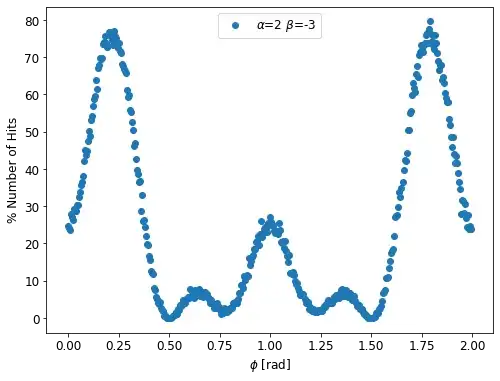

Plotting trials.histogram(key='m')[0] as a function of phi, I get:

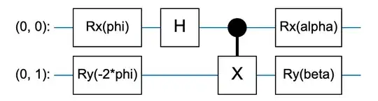

I now have this circuit:
# define two qubits
q0 = cirq.GridQubit(0,0)
q1 = cirq.GridQubit(0,1)
make a PauliSum gate that will return [1] if the state is a bell state b00 (|00>)
z0 = cirq.Z(q0) z1 = cirq.Z(q1) z00 = (((1+z0)/2)*((1+z1)/2) )
define three parameters, x will be varied - a,b are fixed
phi = sp.Symbol('phi') alpha = sp.Symbol('alpha') beta = sp.Symbol('beta')
circuit = cirq.Circuit([ cirq.rx(phi)(q0), cirq.ry(-2*phi)(q1), cirq.H(q0), cirq.CNOT(q0,q1), cirq.rx(alpha)(q0), cirq.ry(beta)(q1), ])
which looks like: enter image description here

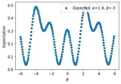

plt.scatter(x_values,y_expectations,label=f'Expected, $\alpha$={a}, $\beta$={b}') plt.xlabel('$\phi$') plt.ylabel('Expectation') plt.legend() plt.show();
Gives the following:
I can split the circuit into two parts:
  1. Input qubits with rotations by the angle \phi
input_circuit = cirq.Circuit([
                cirq.rx(phi)(q0),
                cirq.ry(-2*phi)(q1)
>>> input_circuit
(0, 0): ───Rx(phi)──────
(0, 1): ───Ry(-2*phi)───
  1. The circuit that is going to be my model - aka given some inputs (rotated qubits) these will be entangled and rotated by fixed values that I want to learn.
model_circuit = cirq.Circuit([
                cirq.H(q0),
                cirq.CNOT(q0,q1),
                cirq.rx(alpha)(q0),
                cirq.ry(beta)(q1),
>>> model_circuit
(0, 0): ───H───@───Rx(alpha)─── │ (0, 1): ───────X───Ry(beta)────

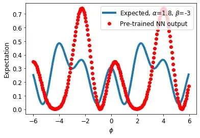

I can test the model (randomly initialised values of alpha and beta given my input circuits:
#test the model
y_test = model([input_circuits]).numpy()
#plot how a randomly initiated model compares with the expected
plt.plot(x_values,y_expectations,lw=4,label=f'Expected, $\\alpha$={a}, $\\beta$={b}')
plt.plot(x_values,y_test,'ro',label='Pre-trained NN output')
plt.legend()
plt.show();

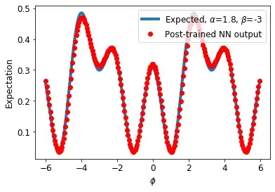

After the model has been trained, I can make the predictions again and see how it's easily learnt what the parameters were:
